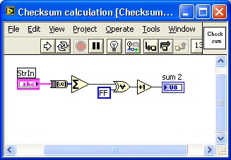

I using a musashi dispenser unit with Rs232 for controller pressure and dispense time. I want to write program in Labview for this. They protocol looklike
DEFAULT is 19200bps.Data Length: 8 bit Start Bit: 1 bit Stop Bit: 1 bit Parity: None Flow Control: None
for instace the Dispense command is stx 04DI_ _(two space) etx
the checksum of this command is CF, which is calculate is 00-30("0")-34("4")-44("D")-49("I")-20("SPACE")-20("SPACE")=CF
can you guys help me calculate this in labview 8.6

This is the programme i am using now, but the calculation result is not right when i type 04DI\s\s in the string the result is not CF

Accepted by lilight
replace your XOr with a subtract node then swap the two inputs to the subtract node.
Note:
THe for loop will auto indedx the array if you let it.
Or you could
String >>> String to byte array >>> Sum Array elements >>> XOr with "FF" then add 1.

  i have replace the XOR node to sustract node, but it does not works, the result still wrong
Message 8 of 14
(9,288 Views)
So now I play a guessing game...
Did you swap the two inputs to the subtract as I posted?
It worked for me so please try to bait that hook again and again post an IMAGE (down loading on one machine and transfering to another just to look!).

  i think i get the right reslut, this is the right VI
