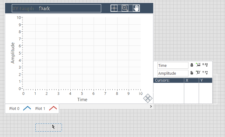

Can reproduce the crash in LabVIEW 2018 64bit.
Curiously, if you try to customize the Plot Legend itself, the crash does not occur. Only when you are customizing the graph control. You just have an empty array. See below.
mcduff
No crash if you pull out the plot indicator when directly customizing the Plot LegendNo crash if you pull out the plot indicator when directly customizing the Plot Legend

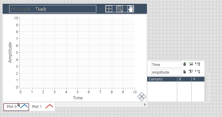

In pictures, not sure what is going on.
  1. Select Plot
  2. Choose Customize control
  3. In Customize Control Window, Select Tweezers
  4. Select Legend
  5. Choose Customize control
  6. You should have a legend window.
Select plot, choose Customize ControlSelect plot, choose Customize ControlIn Customize window, change to tweezersIn Customize window, change to tweezersSelect Legend, Choose Customize ControlSelect Legend, Choose Customize ControlLegend in a customize control window.Legend in a customize control window.
