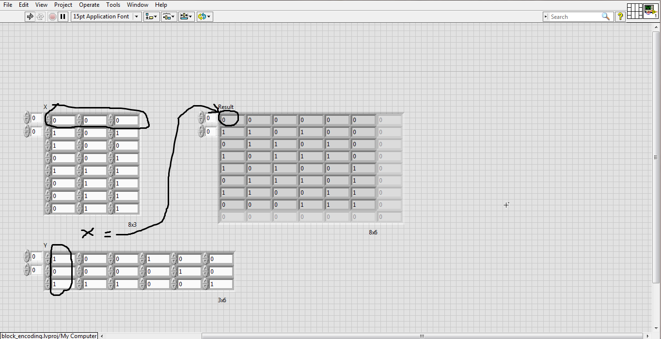

thanks all for your replies, but really none of them gave me the solution I am seeking, i think that it is not hard to understand what i am trying to do- a binary operation(module-2 add and multiply) with two matrices. boolean array is not the solution because it doesn't allow me to enter binary digits(1 and 0).
i had earlier posted my inputs array and expected output array and i am posting it again. i look forward for your kind help
thanks

It IS that hard to understand because what you say you want doesn't match the example you posted.  Answer the earlier questions!
How does the second row of the X array [1 0 1] get combined withe the first column of the Y array [1 0 1], and you only get 1?
How does the second row of X [1 0 1] get combined with the second column of Y [0 0 1] become the answer of 1, yet second row of X [1 0 1] get combined with third column of Y, also [ 0 0 1] and you wind up with a different answer of 0?
What are you really trying to do?  Is this homework?
Message 29 of 40
(2,765 Views)
What Ravensfan said- your example is useless because it tells us only what the result is when we're multiplying by (0,0,0)- plus as he said, you're not directly answering the question. If 'module 2' means 'modulo 2', then what's the problem? Convert to I32, use standard matrix math available in labview, then take modulo 2 of the resulting matrix.
