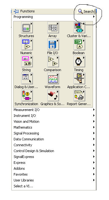

However I use a professional version of Labview. Do you know where the script node is in the function palette?
(3,370 Views)
On your function palette, there is a search button. You can use this to find the matlab script node.
p.s. It's on the Mathematics>Scripts and Formulas>Script Nodes.

I got it. Thank you very much. I find out that the problem came from my Matlab version, I reinstalled it then the program ran well with Matlab script.
