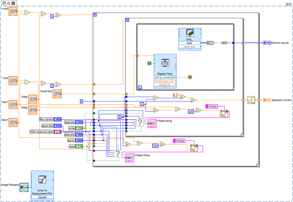

   I am new to Labview.
    I am scanning an electron beam across a surface while counting a signal. I have Labview programs which acquire an XY Graph (X = time, and Y = counts) keeping beam position constant, but I now wish to acquire an image which shows the counts at each point in a raster scan. I am displaying two images in the attached file, one is a dummy and seems to work. However, the dynamic data output from the DAQ seems to cause a series of horizontal lines in the image. I suspect I am not fully understanding how dynamic data works.
Thanks in advance
Chris

Hi slimwalker,
there is a lot to improve with your VI…
See this:
- No need to wire a value twice into a loop using two input tunnels… (I forgot to also rewire the read/write booleans.)
- See the simplification for those FormatIntoString functions? No need to call ConcatString twice afterwards. (Also not the display style indicator at the format string constants!)
- The DAQAssistent is set to read just one value on demand: immediatly convert the DDT wire to that scalar value. No need to convert to an array and sum up that array…
Further improvements:
- Learn to use clusters to bundle all those serial port settings into just one (1) wire!
- After doing so your subVI can be changed to have its inputs ALL on the left side of the connector pane…

Dear Bob,
   Thanks for your advice. I am doing what you describe. I should have given more detail. The DAQ device is acquiring counts from pulses arriving from an electron detector called a channeltron. The VISA VI is sending signals via USB to RS232 to an electron beam controller called PU-EQ 22/35 made by SPECS GmbH.
Anyway, thanks to your help and the other reply I have managed to get the VI to work. The principal problem was that I needed to step the STOP input on the DAQ to true.
I will look into replacing the DAQ assistant - I have partially inherited some code - to get me started.
Thanks again.
Chris

Dear Gerd,
   Thanks for your suggestions. I have tidied up the VI according to your advice. Together with the advice of the other responder I have managed to get the VI to work. I have attached the functioning VI in case it should prove useful to anyone else and an image I acquired using the VI.
Best Wishes
Chris

Hi slimwalker,
even more improvements:
- there is a "+1" function, no need for "1" constants
- when creating a cluster it most often makes sense to wire that cluster into the subVI! That way you don't need to unbundle two times in your mainVI - the unbundle takes place in the subVI! (Can't show that in the image because of missung subVI.)
- Use UnbundleByName instead of plain Unbundle to improve readability of your code. This works best once you create typedefinitions from your clusters!
- I recommend to separate serial port parameters from serial port VISA reference: don't put the VISA reference into the cluster. (Personal reference, just a recommendation.)
- There is a ramp function to create an array of ramp values:
