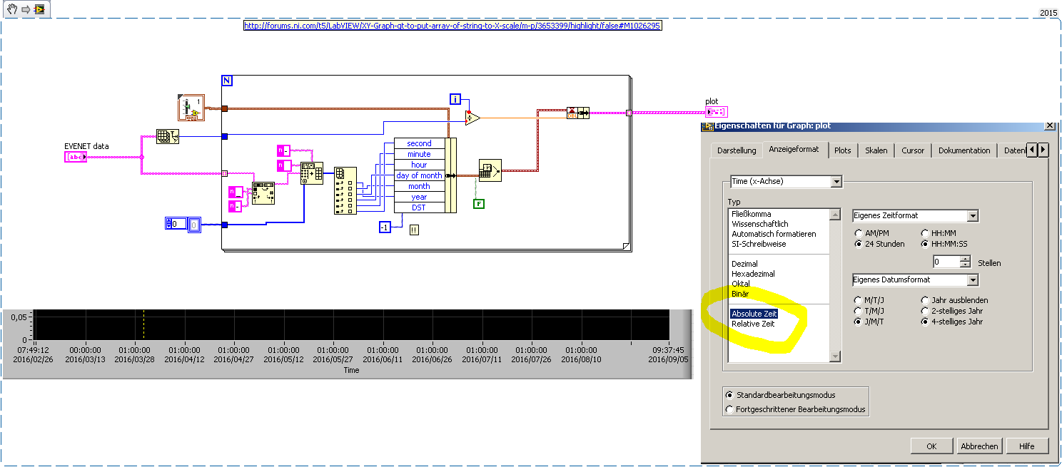

XY Graph => to put array of string to X scale .
How i can to put array of Strings on the X scale on the XY graph .
For example I have two tables of the same size one which represents the axis Y and the other that represents the axis  X (array of strings).
I can do this?
thank you .

If you mean you want to have non numeric values for your markers on the scale,
then as far as i know that is not possible directly with the charts/graphs.
There are properties regarding the markers, but for me the Marker.Text property never does anything and the help seems to not have this option listed.
Perhaps someone has a suggestion on how to build this feature yourself,
but i presume it is involved.

Then I can not put this data in a XY graph as it is presented in the picture?
Message 3 of 18
(6,945 Views)
yes it is possible, because you can use timestamps for the x-axis which can be formatted as you suggested
will attach a snippet later

here we go:

I  get the date, but they not show up on the date cluster?
What is the problem?
Message 7 of 18
(6,897 Views)
Accepted by topic author Sarah_LAB
the picture I attached is a snippet: https://knowledge.ni.com/KnowledgeArticleDetails?id=kA03q000000x2PkCAI&l=en-US
- it's actual LabView Code you can use!
you have to change the graph's x-axis properties as shown in the screenshot

I had already changed the properties!!!
Message 9 of 18
(6,880 Views)
attach your actual .vi, but make sure it got proper default values for the date-array saved
