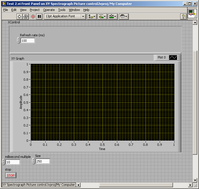

Here's an example.
Unzip and run the "test2.vi" file.
This VI has an XControl on its front panel which in turn has a VI running in Parallel embedded ina  sub-panel on it's facade front panel.
The facade and the embedded VI communicate via notifier when a "Data Change" event is fired.
The upper control (within the subpanel of the XControl) controls a wait within the VI running in parallel which limits the refresh rate.
The lower controls control the rate and size of data being sent to the XControl  terminal in the "Test2" VI.
I can observe the following:
1) With small data sets (200-2000 in size) things seem to work well.  I can send data every few ms to the XControl with a refresh rate of 100ms and changes made to the input data are reflected immediately int he XControl.  This shows that the decoupling of the "Data Change" Event and the data display is working.
2) If I set the data size to a much larger number (25000) The decoupling no longer seems to work and the XControl gets bogged down updating stale date.  I presume this is to do with the time taken to read from nd write to the notifier essentially forcing the Facade VI and the embedded paralle VI into seqential operation.....
Any thoughts?  Any way to get arounf THIS problem?
One thing I really don't like about this approach is that "State" AND "Data" need to be sent to the parallel-running VI in order to simply limit the rate of display.  I seriously think this should be implemented within the XControl framework itself so that all this hoop-jumping is not necessary.
Shane.
