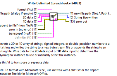

Hello LV Experts,
I am reading 8 voltage and 7 temperature values from Adam device using Modbus Communication. Now I need to write these values to a csv file along with timestamp. I tried "Write text file" but I am only getting a single row and not continuous values with time stamp and also my headers are not getting written. I converted the numbers into string using "Format into String" but I am confused how to loop and which loop should I use to get continuous values. Is there any better way to write to csv?. I am attaching my vi and Block diagram here. I am a student and I am new to LabVIEW. Your help is greatly appreciated. Thanks in advance :')
Message 5 of 13

Hey, Thank you for the reply. I tried "write delimited spreadsheet". Now I am getting continuous values, but the date time is not visible in the csv and for each second, multiple entries are getting generated. I only want to write values every 10 seconds. Also I am unable to add headers to the csv. Please provide me with some more information. Thank you so much.

Hi Varghese,
@Varghese89 wrote:
I am unable to add Headers and to control the duration of writing.
  1. To "add headers" you should write once to your file upon creation of that file and write your header row(s).
    In all later file writes you just append measurement data to the CSV file…
  2. You don't want to control "duration of writing", but "duration of execution"…
    There is no loop in your VI so it runs once and finished. When you want to repeat code (or parts of) then you need to place a loop in your code. Typically you initialize once before the loop (modbus communication, file creation), read data and save to file inside the loop, and finally close all references after the loop!
The date+time is clearly visible, but Excel indicates a "narrow column" with those hashmarks!
Because there is no timing in your VI.
How often/fast do you call your VI?
(I guess you use the RunContinuous button, which is WRONG for production stuff. That button/run mode is meant ONLY for debugging purposes!)
On your code: You could apply scaling directly on your array data, no need to index each element and scale it on its own by using so much duplicated code!
