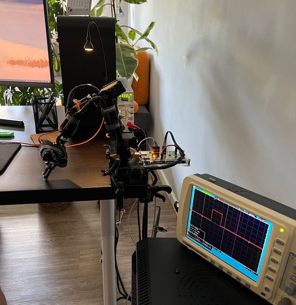

I need to re-awake this topic. I have a Uno R3 and it worked in a first try with 6 servos (DO 8-13). After that I prepared my I2C sensor VIs measuring the position of each part of the 6DOF arm. They work fine and I got back to work on servo's VIs. What is burning in my mind now is the fact that getting back to my servos VI it do not work for more than 3 servos, exactly as described in many posts here... How can it be? In one week I am able to move every 6 servos independently, in the other week the same successful VI simply ignore the last servos. I tried everything, checked every subVI and the command packet, arguments, etc is correctly built. I have also reintalled LabVIEW and Arduino IDE... nothing changes... Attached, the VI I am talking about - nothing special.
In summa: is there nowadays any solution for that? Except using other board.  Thanks and regards!

Ok, I also gave up understanding why Uno didn't handle 6 servos at the same time. Like someone said here "get an ATmega2560 and be happy":-)
My ATmega2560 has just arrived. In 5 minutes connected the 6 servos, 4 accelerometers and 1 compass servos, firmware loaded, press play on the same LabView VI and voilà. Everything works. Now I can focus again in my objective study - a controller. Thanks this forum group and its insights.
bench view - servo pulsebench view - servo pulse
