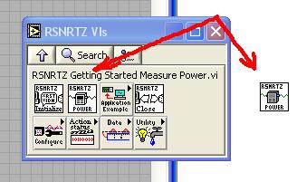

Why when I use Power Meter I have many message of error?
I use Power Meter NRTZ43 of Rohde & Schwartz, but I have a driver, but when i put icon of Getting started on desktop compare this message:
"RSNRTZ Application Measure Power.vi
  Virtual Instrument
    - The subVI expected to be at "C:\work\RSD\drivers\rsnrtz\lv6_vi\RSNRTZ Reset.vi" was loaded from "C:\Program Files (x86)\National Instruments\LabVIEW 7.1\instr.lib\rsnrtz\rsnrtz.llb\RSNRTZ Reset.vi".

That is normal. When a VI is saved the location of all the subVIs get saved with the VI. When you open a VI LabVIEW looks for VIs in a specific order. If it finds the VI in a different place it warns you. You have the instrument driver in the "instr.lib" directory. You have another copy in the C:\work subdirectory. When you opened the "Getting Started" VI from C:\Work, LabVIEW used the VIs from the instr.lib folder.

No because this VI is a VI of ROHDE E SCHWARTZ. See the figure:
I haven't done a VI. I explain myself?

Whoever wrote the VIs at R&S saved them in the directory c:\work\..., you have them in a different location, the good news is that LabVIEW finds them and after you save everything you shouldn't see this warning again.

OK, I see what's happening. When the driver was originally saved it was saved from a working directory instead of from the instr.lib. It's still OK. LabVIEW updated the links. Just re-save the VIs once they open.
