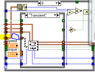

In looking for an answer, I turned on the BUFFER ALLOCATIONS view, and found a place where LV is making a COPY of this buffer, and I don't understand why.
But that would explain things: copying a 1.7 MByte array at 100Hz will certainly put a burden on the CPU.
So here's the code: In the TRANSIENT state, the array is used to pick out and interpolate the next setpoint.
When the test is over, we go to the RAMPDOWN state, where the array is not even used:
After that, we're in IDLING state, where again, the big array is not used.
So, before I re-architect things to eliminate the old setpoints (I have lots of issues with accounting), can anyone explain WHY the indicated buffer allocation occurs?
Note that I show the "0" case, the other case is "default" which handles the other 9 out of 10 cases.  But there's a buffer allocation even there, when the array is not  even connected inside.
More importantly, can I avoid this allocation?

Isnt the size of that buffer read in every case struscture then compared against a numeric to ultimately give a Boolean Output.  Thus it is used in every case structure you have shown as LabVIEW re-examines it in every case as it doent know its a constant.
Educated guess, may be worth a quic recode tosee if it solves the problem.
EDIT
Looking at it again i think you need to show the other cases from the outer case structure, as that is where the buffer copy is occuring.
Message Edited by craigc on 10-14-2009 08:47 AM
LabVIEW 2012
Message 2 of 23
(4,503 Views)
Yes, it is used for that, but it shouldn't need to make a COPY of it just to find out the length.
Don't know what you would have me re-code.  Finding the length should not require a copy.
The "0" case handles setting a new setpoint, the only other case is "Default" which does nothing (the setpoints are interpolated for that).  But even here, it appears to be making a copy, A fact that I don't understand.

It is hard to say without poking at it but I have seen similar patterns result in an extra buffer copy.
1) (Least probable) The wire forking to feed the array size is confusing LV and it thinks it needs another copy. I saw this in about LV 7.1 and may not apply with LV 8.6.1.
2) The sub-VI  "used to pick out and interpolate the next setpoint" does NOT have the control on the icon connector on the "root" of the diagram and or the data is not wired through. To understand what I am getting at please refer to the "Clear as Mud" thread where Grg McKaskle was called out of retirement to explain how sub-VI's can work in the buffer of the caller (this is really what you want to happen in the code you showed us).
Reader's Digest Version:
When LV "sees" data be passed into and out of a sub-VI and there are no operations that will modify the contents of the data, the data will be passed by reference so the sub-VI will do its work in the callers buffer.
This code image shows the difference.

Well the array size function is in all your case's so to be pedantic it should be done outside of the case strusture.  Inside it is just bloating your code and still may be the source of the buffer allocation.  Apart from that its the only thing i can think of.  Have you tried to turn on constant folding?  If the bundle is not a constant then LV will re-evaluate it within each case 🙂
LabVIEW 2012
Message 5 of 23
(4,487 Views)
Oh and Ben has prob hit the nail on the head.  I went through that sometime ago and have forgot about putting controls inside the case structure of sub VI's I put them on the outside as matter of fact now.
I also got told of about 6 months ago for having duplicate code inside case structures 🙂  Putting them on the outside makes it easier to read too imo.
And i have noticed you havent got the same array size function in there anyway so apologies for that .:( coffee time i think!

I verified that there is NO possible path through the code where the array gets modified after this unnecessary copy operation.
Hmmm.  If I break the wire (indicated in blue) carrying this array to the inner case, it STILL makes a copy, even though the ONLY connection to the array is to the ARRAY LENGTH function.
Why does it need to make a copy just to find out it's length?

I suspect that you can solve this, or at least narrow it down further, by having the setpoint array pass through the case structure and back out to the shift register, rather than forking the wire at the top.  My guess would be that there's something inside Transient Setpoint Manager that causes the copy, and that if any one case in a case structure requires a copy then LabVIEW makes a copy for all cases (I can imagine that this simplifies memory management if it's not dependent on which case in the case structure is selected).
Given that I removed the OTHER fork (see above pic) and left ONLY the ARRAY LENGTH function and it STILL made a buffer allocation, I'm raising the odds in favor of LV confusion.
--- Well, the data is not wired thru, because it does not need to be.  It's never modified within this section.
As far as the subVI not having it's terminal on the root level of the diagram, well, that's not the case:
However, the array is passed on to a further sub-subVI, and in THAT case, it is NOT on the root level:
I will move that and see what happens.
I don't understand it though.  In no case could the array possibly be modified.

Greg McKaskle is/was there at the meeting when the details of "in-placeness" were being worked out. He explained thing in the Clear as Mud Thread. LabVIEW can recognize the "wired-through on the root" code pattern as "data not modified".
If simply doing the wire through to that sub-VI and its sub-VI is not enough to get the in-placeness to change its mind, follow through waht I think I heard Nathand say when he suggested wire the data through all of the casses of the case structure with the extra allocation.
