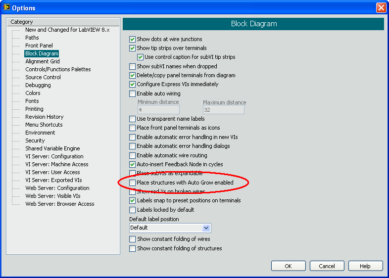

The setting for this, by the way, is in the LabVIEW options (Tools->Options):
Message Edited by smercurio_fc on 02-08-2008 12:03 PM
