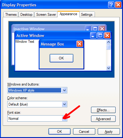

Go to the windows control for Display properties and select font size=normal.
You can also change the default diagram font for new VIs in LabVIEW, but it won't affect existing VIs. You would need to e.g. select all objects on the diagram and press "ctrl-" (control+minus) a few times to make the current fonts all smaller manually. I don't recommend this though.

You also mentioned that you had changed the DPI settings, which I presume you did by going to Display Properties->Settings->Advanced->General. The default is 96 DPI usually. You should change it back to "Normal" and see the effect.
Interestingly enough, in some cases having the DPI at a setting other than "Normal" will cause graphical glitches in GIF images on a web page with Internet Explorer.
