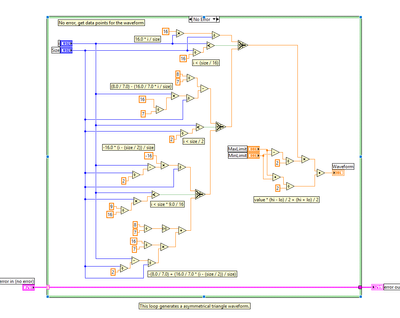

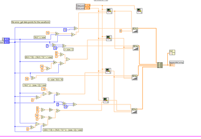

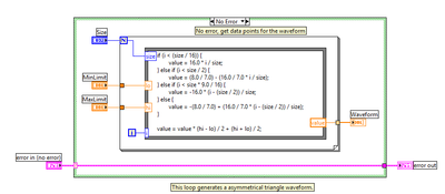

Heyy all,
Case 1 - Function Node subVI
Everything is straightforward, you just need to call this subvi in the main loop
Case 2 - Select subVI
The same thing but with Select. The 'i' will be passed from a 'for' loop in the main vi where this subvi is called.
So my question is which case would you use? I feel like case A is concise and easier for error checks.
Also, is there another efficient way to do this? Advice appreciated! Cheers and hope you have/had a great day!

Hi Ram,
None of them…
It seems you create a "waveform" (better: an array of samples) by appending 4 ramps.
Why not use the ramp function (4 times) and a simple BuildArray node?
As said before: LabVIEW comes with several basic waveform generation functions: use them!
LabVIEW also knows about a waveform datatype, that consists of more than just an array of samples. Use the correct wording for your questions!
Also generic advice: ask for WHAT you want to achieve, don't ask HOW you intend to achieve your goal!
You will get much better help when you describe your requirements (like "I need a waveform of ramp up, hold, ramp down, hold") instead of "should I use a formula node or some select nodes"!
