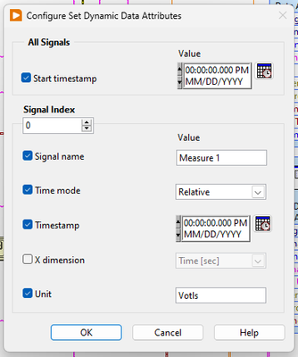

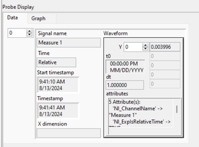

  • The waveform chart (or graph) moves as if the magnitude is updating, but never plots. The time stays at 0 plus or minus a few seconds. (pictured below)
  • Using a probe on the dynamic data, one of two things happens.
    • The t0 in the waveform always updates to the current timestamp, and dt stays at 1
    • the t0 in the waveform stays at 0, and the dt stays at 1.
  • This makes it look like In the loop, it is always sending the "first" point, and updating as such. I have tried everything I can think of short of manipulating the waveform data points in the loop w/ "Update Waveform" VI.
  • Note: There are two shown here to illustrate the two changes I have found, there are ultimately 4 signals i want to plot, but assuming the same issue will fix them all.
Issue 1 - probe display and Set Dynamic Data Attributes Config
Or Issue 2 - Probe display and Set Dynamic Data Attributes Config

Yes, I can see that, I actually turned that on so that I could verify the probe data was making into the Waveform VI. It is just graphing 1 point over and over again. I am trying to see why, and wondering if it is a timestamp issue.

Thanks, I knew that was coming. I actually said it at the top, so thanks for reading that. As soon as I post that, the next comment will be "hey, that is too new of a version, post another on a compatible version" and so on. I was looking for actual conceptual ideas and feedback on things to try. I did post what is inside them, that is what the configuration screenshots were for.
