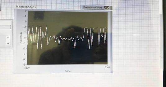

We utilized the Analog Input from the myRIO to get a waveform from a signal generator equipment (sine wave). But the result from our oscilloscope is different from the result in waveform chart in labview.

Here's the oscillocope outputHere's the oscillocope outputHere's our Front Panel outputHere's our Front Panel output

Hi James,
do you use the very same sample rate with both devices?
In your myRIO VI you use 16.6Hz sample rate due to this 60ms wait function.
With your scope you use a time range of 200µs per div!?
Message 6 of 24
(6,858 Views)
When we put the same sample rate on both device, the signal doesnt look the same. The output in front panel is not giving us a sine wave. We really think that the problem lies in the acquisition of values from analog input. We need to plot the values from the analog input into a waveform. Thankyou

Hello jamescpe,
I beleive you are directly acquiring the data from the RIO and thats the reason why you are losing the data in the process.
Try to create a FPGA file and also a FIFO. Send the acquired data from FIFO and receive it in the host aaplication through FIFO.
