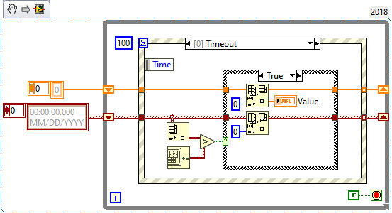

Hi... A beginner here. I have a vi that writes value in real time in "VALUE" variable.
1. When I press auto cycle "value" should be updated with random number in every 10 sec span.(6 times)
2. I want to modify my code such that if I give input to "SET VALUE" anytime it should be able to update variable "Value".
3. A value can only have input of set value during particular 10 sec span and after that again value takes random variable for next cycle of 10 sec.

You're mixing (at least) 3 paradigms.
You're
+ polling (control-> indicator)
+ using events (Boolean trigger)
+ looping with timer (time out and wait for multiple).
This won't work well. You can of course mix event driven design and timed loops, but to do it properly (growable, maintainable) you'll have to step up architecture a bit (for instance queued message handler).
Event Structures work best when no event takes significant time to execute. The loop with timing is a mistake. It will ruin event driven design. It can work, if the event should block user interaction until it is done, but that's not what you want.
For now, for learning, you can keep it simple.
I intentionally do not hand you a complete solution.
So, you catch events:
+ The Boolean should trigger automatic updates of the value.
+ The Set Value should update the value manually.
+ On time out, you can do things.
A note on the TO. Note that TO does not trigger when events keep coming in. Add for instance a mouse move event, and no TOs will trigger until you stop moving the mouse. In you're project, this is no problem at all. Set Value should probably interrupt the timed updates. The Boolean should too.
+ In the Boolean value change event, set the random numbers, and times they should trigger. So, 2 arrays, one with numbers, one with timestamps. Optionally (not sure what the design is), add to the arrays that are there.
+ Put the arrays in two shift registers.
+ In the time out case, compare the time with the 1st timestamp. If it's time to trigger, remove the value and the timestamp. If the array is empty, don't do anything.
+ on the Set Value event, update the value. Optionally (not sure what the design is) empty the array of values and timestamp.
Here's a quick mockup. Just a small peace of the puzzle, what is shown is all that's implemented:

Thanks for the suggestion. I understood the events. I created the code I wanted and it is working fine. I am attaching the code here. Is it optimized? or can I create better version of it?

"In the time out case, compare the time with the 1st timestamp. If it's time to trigger, remove the value and the timestamp. If the array is empty, don't do anything."
Lost track here.
Lost track here.

This seems pretty self explanatory to me, although I wouldn't worry with an array. Just keep the starting time in a shift register or feedback node and update it when a new timer is started.
