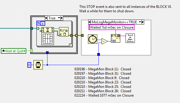

I have a window which comes and goes, during program operation.
This window has 72 subPanels, each containing a reentrant copy of the same VI for a "block".  I insert the VI in the subpanel, and then run the VI with a CALL and FORGET call.
When the user closes the window, all the block VIs terminate, and the window closes.  I don't care if the closing behind the scenes still goes on after the window disappears.
But when the user QUITs the program, with this window up, I need to make sure that all the block VIs have terminated before I shut down other things (close files, etc).
To that end, I changed the CALL and FORGET to a CALL and COLLECT operation, and installed a WAIT ON ASYNCHRONOUS CALL for each instance at the end of the big window code.  This is after the blocks have been commanded to die (via an event).
I see from the debugging file (a portion is pictured) that it takes over 1000 mSec to wait for all the instances to die.
The thing is, if I change that "0" to "1000", then what I would expect is that the actual waiting time would drop to < 100 mSec.
My thinking is that during that timed wait, the blocks would be dying anyway, so it would take less time to actually wait on them.
But when I do that, nothing really changes.  The listed time is still over 1000 mSec.
If I limit the number of blocks to 12, the time is 97 mSec, for 24 it is 185, for 36 it is 576, and so on - it's proportional to the number of blocks.
So, what is really happening?  If it's just waiting on things to die, why doesn't the timed wait affect the numbers?

Have you checked how long the first loop of the For loop takes, versus all of the others?
I wonder about the order in which your subVIs close, versus the order in which you wait to collect them. Let's say that you send the stop messages in the reverse order from how you're waiting to collect them. If the last one to stop is the first one you're waiting to collect, that first loop cycle will take a very long time. After that it should go more quickly, but assuming there's some fixed amount of time required for each collect, it will increase proportional to the number of instances.
Also, I'd expect that it will take 72 VIs a while to each receive and process the "Die" event. Is that still occurring while you're waiting to collect?
--- I thought about that.  It's an EVENT that stops them. Each block has an EVENT loop and they all receive the same event.
I can't (nor do I want to) control the order in which they quit.
So yes, the first loop will wait on block #0 to quit, but that could be last to actually quit.
But that would be OK - if #0 is the last to quit, then I would expect the other 71 blocks to just breeze right thru.  If all it's doing is waiting until it's dead, then it's faster if they're dead already, right?
I send the STOP event, close the big container window FP, and then wait to collect.  I tried waiting before closing the panel, to no good effect - it just keeps the window up while I collect.

Just to make sure, because you only show parts of the diagram:
When does the "wait" start executing? While it does not have any data dependency (and thus can start immediately) the loop depends on the references, so we can't really tell how long it takes until they arrive and the case structure is allowed to execute.
Can you add a few more timestamps, e.g before and after the for loop? For comparison, what results would you get if you would put the wait inside the case structure instead?
--- A reasonable question.  In frame 4 (of a sequence), there is an event loop.
Code outside this big window issues a STOP event.
This event is registered by the container window, and by each of the 72 blocks.  They all see it.
The container window, reacts by stopping the WHILE loop in frame 4
In frame 5, it stores a single integer into a PREFS (.ini) file and closes the front panel.
In frame 6 is the COLLECT code you see above.
