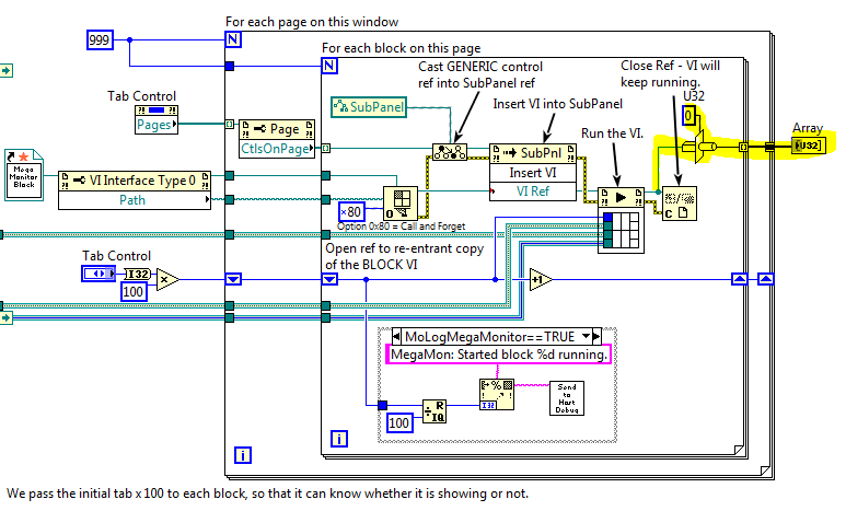

  • You may not be enforcing that your 'start ms' is actually your start ms since there doesnt appear to be a dataflow dependency.
--- It's not shown, but the timed wait and the VI RefNums are in a sequence frame - there is nothing delaying the Refnums arriving, relative to that start time.
  • Async calls are actually a call pool, so you may have 72 refs in that array but they should be equal to one another. Meaning you really just need the ref and a count.
--- I'm not sure why you think that - I don't think that could possibly work. If I had two calls to the same VI, I should be able to do something to one of them without doing it to the other, and if there's only one ref, that cannot happen.   In any case, I tested it and I get a different RefNum for each instance, as I would expect:
The highlighted code is added just to test this idea:
If you look at the RefNums:  RefNums.PNG

--- I tried decimating the array into four arrays of RefNums and running four FOR loops on those.  No change.
The bottom line is, I think I've gone as far as I can.  What I thought would be a more elegant solution (call and collect) turns out to have its own price.
My ORIGINAL original plan had a simple RUN VI call, and I had to SET CONTROL VALUES before that, to pass parameters into the instance.  The CALL AND FORGET is an improvement over that.  But I don't think that CALL AND COLLECT offers any benefit.
With CALL and FORGET, I can choose to do the wait or not, as necessary, without consequence.
