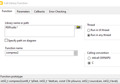

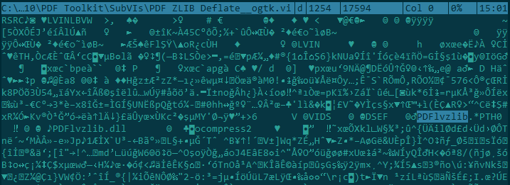

In PDF ZLIB Deflate__ogtk.vi everything looks fine, I will not show password-protected diagram, but it looks like the full absolute path is not stored here:
So the call looks like that:
And the DLL is located in the same folder where SubVI.
Message 9 of 15
(4,228 Views)
Not that there is anything secret in that VI. If you download the OpenG ZIP library you will get the according VI containing that Call Library Node without password. 😁 It's name is ZLIB Inflate.vi and ZLIB Deflate.vi.
I think I see why it doesn't show up in dependencies. I used the wildcard name in the Call Library Node to make it work for Linux *.so and Mac *.framework too. Seems the dependency view doesn't resolve these things, only the VI does at runtime.
However while the path is indeed entered without full path and accordingly stored, the Call Library Node dialog usually tends to resolve the path anyways when its opened again to show the full currently used path.
