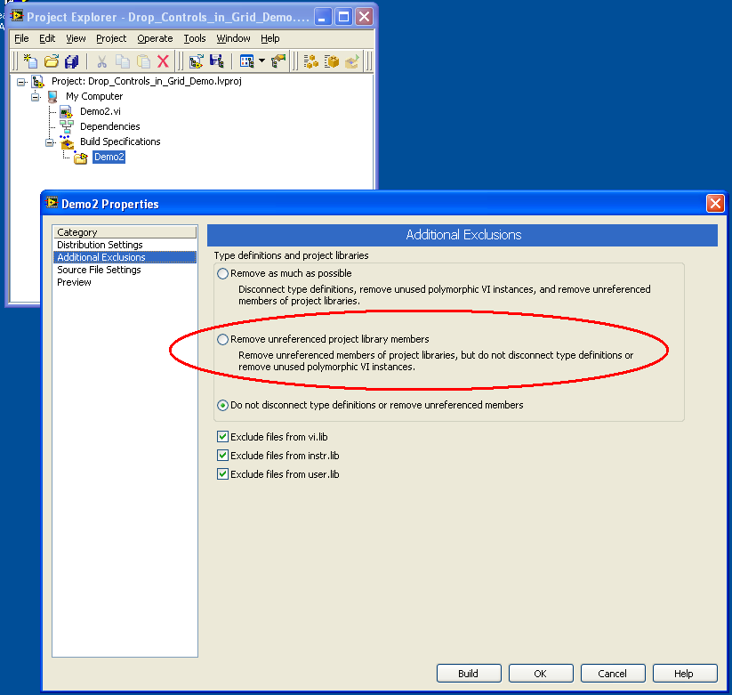

Hi All,
I have a project (that I can not post do to super secret nature) that shows an error while attempting to build (a source distribution).
I get the same error when I attempt to do a "preview".
The error message I get is
Unable to generate preview. An included VI or one of its dependencies does not exist. Open all  Startup/Exported/Dynamically called VIs, recompile them  (Ctrl-Shift Click the run arrow), and save them to update their dependencies.
<Call Chain>Error 7 occurred at ABAPI Dist Report Read Link Info Error.vi -> ABAPI Dist Cmp Settings to Disk Hier.vi -> ABAPI Get Settings From File2.vi -> SDBEP_Invoke_Build_Engine_Preview.vi -> SDBUIP_Build_Rule_Editor.vi -> SDBUIP_Item_OnDoProperties.vi -> SDBUIP_Item_OnDoProperties.vi.ProxyCaller
Possible reason(s):
LabVIEW:  File not found. The file might have been moved or deleted, or the file path might be incorrectly formatted for the operating system. For example, use \ as path separators on Windows, : on Mac OS, and / on Linux. Verify that the path is correct using the command prompt or file explorer.
NI-488:  Nonexistent GPIB interface.
1) All of the files are there.
2) I opened and saved all of the VI as instructed.
If I select "removed unreferenced...." it build OK.
BUT... I don't have any libraries in the project. Smiley Tongue
Can anyone explain what is happening?

Ben,
Without the actual project I can't say exactly why, but I have a good idea.
So it works if you choose 'Remove unreferenced project library members' but it doesn't work if you choose the third option which is essentially include everything.  Your project may not include a Project Library but one of the subVIs of the VI you wrote must include a project library somewhere, even if it is a vi.lib or instr.lib one.  If you refresh your dependencies node in project explorer it/they should show up.  So the problem comes in where your VI or one of its subVIs uses a VI in a project library but there is another VI in the project library that your code isn't using that is missing.  So building removing unreferenced project library members will work just fine since you aren't including the whole library, but including everything won't because it copies the VIs your app uses plus everything else included in the project library and there is a VI that is missing.
After refreshing dependencies and expanding any twisties you should see a [Warning: File doesn't exist] message.  That is where the problem most likely lies.
Now it would be really handy if App Builder would tell you what VI it thinks is missing maybe who is calling it and what to do about it (CAR 3ZCF7KJ1).
Another reason this can come up (which is what I think Mike ran into) is that Source Distributions by default in 8.2 include everything in the project (you have to opt out of including something rather than opting in like with building EXEs/DLLs) so if there are any items in your project that aren't actually on disk you'll get an error 7, you need specify not to include them in the Source Distribution.
Kennon

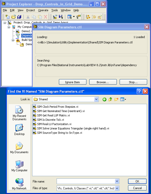

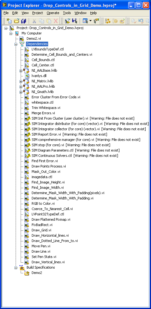

Hi Kennon,
Here are my results.
I did the rfresh and got the pop-up looking for a "SIM" Vi. See image.
I canceled and got a buch more
SIM Continuous Solvers.ctl
SIM Init From Cluster (user cluster).vi
\SIM Integrator for core.llb\SIM Integrator distributor (for core)(vector).vi (X2)
..\SIM Report Error.vi
\SIM Integrator for core.llb\SIM comprehensive manager (for core).vi
Took screen shot "Proj_After_Refresh.png"
saved proj
Generate Preview >>>> Same error
removed missing stuff and re-saved project
Same error
Expanded all and could not find anything else missing.
Did another refresh >>>> the SIM stuff I deleted was back!
So how do I tell who/what is calling the SIM stuff?
Is this just a bad install?
Ben
Ben
Message Edited by Ben on 07-13-2007 12:27 PM
The SIM stuff will keep coming back because some other VI in the same library as one of your VI's dependencies is calling it.  And because your dependency is dependent on its owning library, all of that library is also a dependency (if that makes sense).
Right clicking on the VI and choosing Find>Callers would be very handy but isn't in 8.2 and really should be added Smiley Wink.  You can easily find where those VIs are supposed to be by right clicking on the Project item at the top of the project explorer and choosing View>Full Paths.  You'll notice this SIM stuff is in vi.lib so it should be installed and if it isn't there (right click on one and choose Explore to jump to the folder) rerunning the LabVIEW installer and doing a repair would be a good idea.
