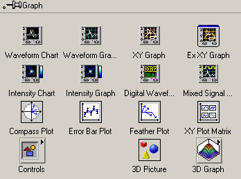

The polar plot was actually the first thing I was looking for but just upgraded from 8.5 to 2009 and did not see it on the graph palette, so I thought it had been deleted (the active X surface graph for LabVIEW 64-bit is not available).
polar.png Did not see polar plot on the main graph palette
I should have done a search for it - it is located on the classic palette in LabVIEW 2009 32 and 64-bit.
I will look into this as my first choice and post any results.
