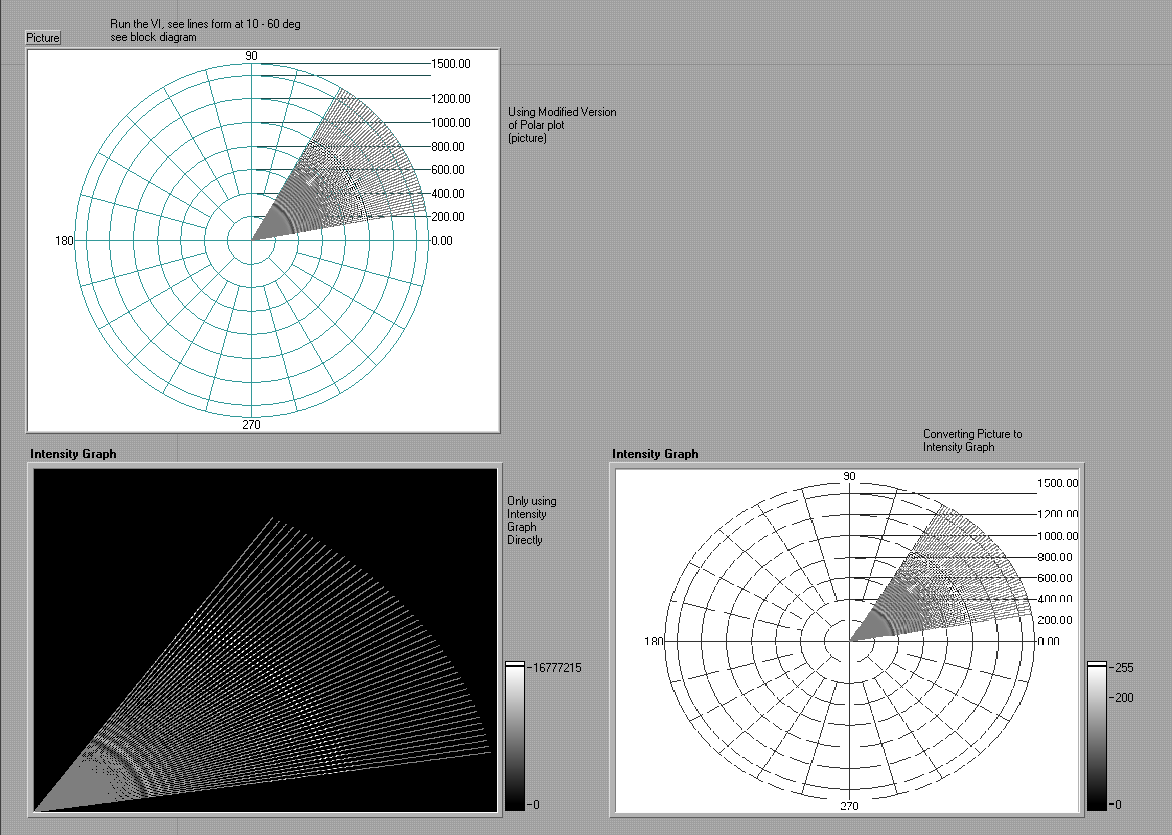

...problem was phase angle needs to be in radians....Don
Message 22 of 30
(6,149 Views)
This one has a few updates after a some more time to play today.  Plotting multiple lines, converting from picture control to intensity graph demo, etc.  Converting from picture control to intensity graph demo works for gray scale.  I have never figured out the correct way to get that to work for a non-gray scale color table using the 24-bit pixmap for the picture control.
As discussed earlier, there are gaps between the lines.  Not yet sure of strategy to average, possibly drawing the lines in a much denser fashion than with 1 deg increments.

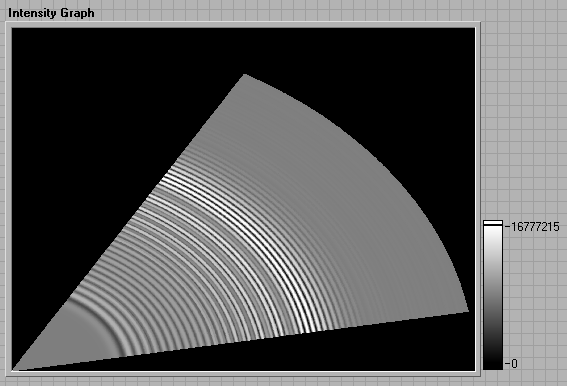

If we plot 500 lines (versus 50 in the example above), each separated by 0.1 deg (versus 1 deg in the example above), here is what we get (just showing the direct intensity graph plot).  0.1 deg seems about right.  At 0.2 deg, you will see a few gaps towards the outer edges.

Hi folks -
Getting back to this problem today.  Have made more progress on this with actual data.  However, I am wondering if there is a geometrical transformation using the intensity graph that will allow me to shift the starting locations of the lines to account for the fact that ultrasound has finite beam width.  The starting points need to "fan out" slightly, with the rest of the line proportionally fanning out while keeping the end points where they area.
I tried to embed images here to show what I am after but got 10,000 characters exceeded so am just attaching images.
Note at the top left corner of one image, there is a finite beam width near 0,0.  The lines do not all meet at 0,0.  So again, the line starting points need to be shifted slightly while keeping the end points the same.  I know the distance of the maximum shift, and think the shift of all starting points would be proportionally reduced from the max down to 0 to achieve this effect. But the rest of the points in each row have to be shifted as well to effect the geometrical transformation. But, again, I am stumped on how to implement this for the 2-d array of the image, row by row.

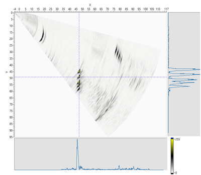

Hi Don
I've used the intensity graph and managed to implement the phase corrections and offsets. This is an image from a steel block with five side drilled offset holes at different depths.
Regards Deon
