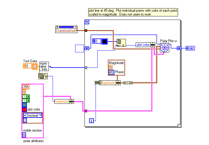

Here is actually the more correct version of what needs to be done to plot one line.  Maximum is actually the size of the array.  Each point is color-coded to scale to the magnitude at that particular location.  But again, this does not seem to work.

Christian posted code to draw arrows using a picture control. I have attached same.
If i follow what you want, you want a line from the origin toward some direction that varies in color along the line. If you are using 8 bits you only have 256 colors so an y vector over 256 will have some adjacent pooints plotted in the same color. That is where Christian arrow (minus the head) come into play.
Moving forward, you will repeat that for other vectors starting at a diferent location and it will be the over lap between the plots that will define what you are after (I hope I'm not in left field).
Over-lapping points in a picture control will replace the old color at that pixel so I think you loose the over-lap.
It seems that you would want to render each set seperately and then average the all of the resulting colors at each pixel.

I think you have it mostly right but we do not want arrows of any kind.  If you go back to my original post, I even show the compass plot without arrows.  Yes, say we have a signal with 1000 points (locations along the line).  Then we want to draw a line from 0 to 999, increment of 1, along a single direction, say 45 deg.  The signal for simplicity can be scaled to between 0 and 255 as I have done (this step is not really necessary but makes the code more straightforward because of 1 to 1 correspondence with a 256 value gray scale).  Then we have a corresponding gray scale with 256 gray values varying between 0 and 255.  The color plotted at any given point (location along the line) = the magnitude of the signal at that point (location) if we have scaled the signal to between 0 and 255.  This is for line #1.
Then consider that we might have 20 lines between say 25 deg and 44 deg.  So we then do the identical procedure for the next line at the next deg increment, which is what you have understood correctly.  The rest of the plot might be color-coded with a background color (black or white or middle gray).
I think I/we have to dig deeper into the polar plot.vi and see if there is a way to modify it so that it can do this.  But out of the box, unless there is something obviously wrong with my code, it does not seem possible.
There is also might be some way to using polar functions to  do this type of thing directly using an intensity graph, given some clever programming that I have not had time yet to consider.
I just thought it logical to first start with LabVIEW native graphs that LOOKED somewhat similar to phased array displays.

I had to dig into the subVIs.  For the 'Plot Polar Data' subvi, I had to use 'Draw Point.vi' vi instead of 'Draw Multiple Lines.vi', and run thru a for loop in order to plot each point.  To illustrate what I did better, I used a color table rather than a gray table but I left in the gray table on the diagram so it is available.  The draw of 1500 points is actually fairly fast.
You made a good point, by the way, in an earlier post.  Some averaging will have to take place between multiple lines to generate the true phased array plot since the angular lines diverge away from each other.
The arrows draw you guys did was pretty cool.
Next steps then would be drawing multiple lines, averaging on the display to fill gaps between lines, and conversion to array data for intensity graph plotting.

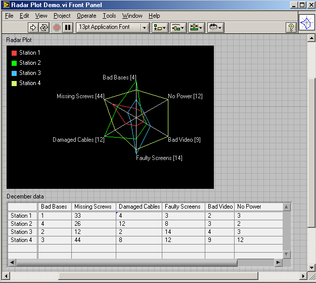

So I'm walking away from this question thinking "Yes that phased array image should look just like what I used to see on my search radar with the difference being that you will have multiple plots with the origins dispalced..." when it hit me.
THere is a "Radar Plot.VI" available under the Pictures pallette.
Did you try looking at that example?
Ben

At first glance, I don't think the radar plot will do what we want....
You know you are getting old when...
Hmmm right name wrong code.
Sorry about the wild-goos chase there.
Ben
