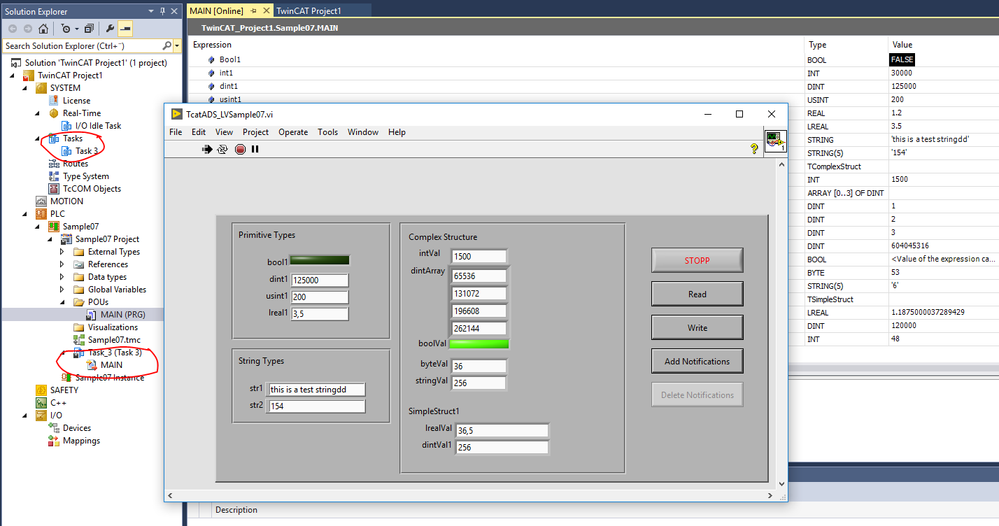

I encountering an error (1172) when I try to read / write values to a Twincat PLC program.
The program I'm using is a sample program developed by beckhoff (attached in link below).
I have marked where the error occurs.
I have accomplished to read / write string variables to the PLC, so the connection works
I hope some of have have an solution 🙂

I assume that you have loaded the correct TwinCAT project, i.e., the one that is included in the Sample07.pro file. Do not have access to TwinCAT currently to open and check the contents of the .pro file.
However, the error that you get seems to be coming from one/many missing variable(s) in TwinCAT. Check whether MAIN in the PLC project that you are running has variables Bool1, dint1, usint1, lreal1, str1, str2, and complexStruct1.

OK, the problem it seems, is due to a missing task containing MAIN in the Sample07 TwinCAT PLC project.
As you can see, without any modification if I compile the project, MAIN is grayed out as it is not referenced by any task.
Original without referenced taskOriginal without referenced task
After adding a new task (Task3) and creating a corresponding reference task (Task_3) in the Sample07 PLC project to which MAIN is assigned, everything works ( or sort of, the complex cluster doesn't work 100% but that you should be able to debug 😄 )...

Thank you for the answer..
I completely failed to see the sample.pro file (I did make my own TwinCAT PLC program)..
But I tried your suggestions, and if I compile without any modifications it works fine.. I did not need to add a new task.
