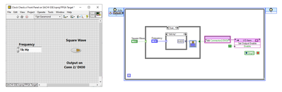

I am using a PXI-7842 FPGA module.  I'm trying to output a 10MHz square wave on one of the DIO channels. I am using the Square Wave Generator VI from the FPGA Functions pallet.  I get a somewhat decent square wave up to 1MHz, but at 10MHz, it's a sawtooth wave form.  I am using the FPGA's onboard 40MHz clock. How can I get a cleaner waveform?  Or are there frequency limitations?

Here is the code I'm using.  I've also attached a copy of the VI.  It is a fairly straight forward program.  I'm simply using the supplied function "Generate Square Wave.vi".  I've also attached pictures of the waveforms, using a Tektronix TDS 3034 oscilloscope.

Creating the 10 MHz Signal in a FPGA is simple, just toggle a value with 20 MHz 🙂
And now: Wellcome to the analog world 😄
There is a long, never ending 😉 discussion on how much bandwidth you need. ... Infinity in theory ... 20  times the base frequency is a usual pratical value ... .
If you show that signal by hand you will find that as higher the frequncy goes, as more force you need.Newton law (F=ma)
Sort of same for the analog signal. (and even for the 'analog' digital memory cell in the  FPGA ) .. to make it faster you need to make it smaller, reduce the amplitude or you need more energy for switching 🙂
That you see a sawtooth is a strong indicator for limited slewrate (limited force) . If you look closer to your slow signal, I bet you find about the same slewrate there..  So too much load at your signal output (or your scope isn't fast enought.. but this kind of problems vanish nowadays)  . Fast Probes that don't put to much load on a signalsource is still a common problem.
Try an active (expensive) FET- Probe or a correctly compensated 10:1 probe ..
A 10:1 probe has a 9M resistor at the input in parallel with a smaller capacitive load (ten times smalller than your scope input)
Or put more force on the output: Use 4 or 8 outputs in parallel .. but still build a correct termination (here I simplify .. i have no information on the sourceimpedance of one output)
