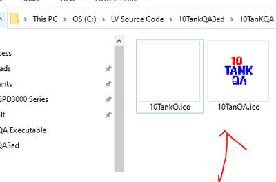

My icon looks as I want it to look on my file as you can see below.
On my project file, it's not showing at all (see picture below):
By the way, I am using 16 x 16, 32 bit to create it.
I tried 32 x 32, 32-bit, the writing 10 TANK QA does not fit.
How do I have the 10 Tank QA fit?

Use NI's Icon editor to create a real .ico file with a whole set of images.
    ..\LabVIEW xxxx\applibs\iconeditor\iconedit.exe

It could be an image cache problem if you changed the ico file.
Try rename the ico file, and then add it back to the project.

It's one of those sizing Things! The icon for a *.ico file shown in the project explorer is not the same size an exe uses for the icon at the top left of the Windows window.  The native LabVIEW icon editor does need a substantial update to save *.ico files with multiple sizes.  WORSE! there is no good way to launch the poor tool from anywhere other than an exe build spec!  ( no add>> new...icon, no Tools>>icon editor, noway nohow)  someone should really drop an IDEA in the idea exchange to make the feature actually functional. 🤔

The icon of a windows executable has very little to do with LabVIEW. Not sure why NI would need to reinvent the wheel here.
In any case, you should definitely create an ico file that contains all the major sizes. I guess you did not include the very small version.
