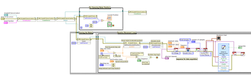

I am using LabView 2023 Q1 to create a motor control and start data acquisition. I am using a ThorLabs KDC101 Motor Controller and a simulated data acquisition tool through NIMAX (a USB 6361 - BNC). The general idea is: the motor will move by a set step size, the motor will stop due to a preset delay, during this delay data will be acquired and written to a file, and the cycle repeats until the end position is reached. After the end position is reached, I want to average the data values in each row of the file and obtain one vector.
I have achieved the motor movement, but the time delay I have step up between steps keeps returning an error (Thorlabs.MotionControl.DeviceManagerCLI.MoveTimeoutException. I am also struggling on how to write the data I am simulating to a file.

Thank you for your reply. I attached a zip file with my project and VI. Do you have a recommendation for how long I should set the time out?

Thank you very much! Follow-up question: I am attempting to save my simulated data to an excel file.
Currently, all simulated data is saving in one column, no matter how many iterations of measurements are taken (for example, if I set the motor step size to 1 and end position to 4, there will be 5 iterations). I would like my data to save to an excel file with iteration amount of rows and number of samples amount of columns.
I'm only using one channel, so if I try to use an array, I am unsure how to change it since my data is 1D.

You could try wiring the waveform output to the edge of your while loop, right click the output tunnel to change it to "indexing", and then wire the 1D array of waveforms you get to this VI:
https://www.ni.com/docs/en-US/bundle/labview-api-ref/page/vi-lib/waveform/wdtfileio-llb/export-wavef...
