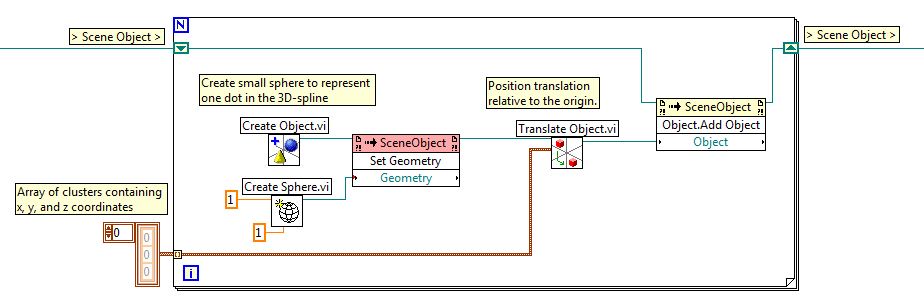

From your picture it appears that you already have a 3D Scene that is titled Simulator Display. Is this VI an example that was provided to you? Or did you write this VI?
This is not something that I have done before, but assuming that the item titled Simulator Display is a 3D Scene or 3D Picture, you could trace the path of the end-effector by keeping the 3D locations of the end-effector in an array of clusters, each with an x, y, and z location. 3D Scenes/Pictures are used to represent physical objects in a virtual environment, so each location that you want to plot would become an object. Below you will find a snippet where I created a for loop that will create small spheres for each point stored in a predetermined array of clusters. Those spheres are created, moved to the correct location, and then added to the exisiting 3D Scene.
Your application could be different than what I suggested, but you should start by looking at the Solar System example shown below. This example shows how objects are created, added to scenes, and interacted with.

Mr Watts;
I have analyzed your advice again, and I have built what I want to do.
The trace of end-effector can be drawn with your block diagram.
Only thing which should be done is adding a "Get Reference" block to the diagram.getreference.jpg
After this select "Scene" for this block and set the flow like this;
By this block, the trace of the end-effector can be drawn at desired position.
Thank you again
