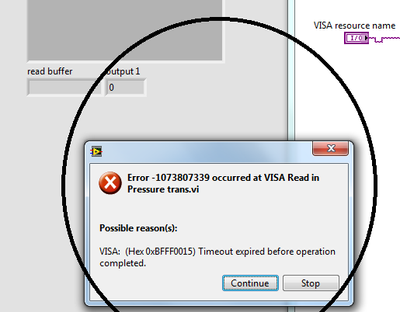

C. I tried to create the block diagram it shows the following error? I didnt understand it clearly.
D. I  tried to create the block diagram without the loops it shows the following error? I didnt understand it clearly.
They both show the Same ERROR.
Any  advice How can I run my block diagram?

Hi skdubey,
It's a little odd that the com port is being renamed each time, that might be an issue with the converter you're using, in any event, in my humble opinion, you're on exactly the right path at steps C and D.  The next thing I would recommend is wiring constants or controls to the settings for Baud Rate, Parity Bits, ect. on the block diagram of your "Pressure trans" vi.  The settings for these should be provided in the device documentation and might be different than the defaults.  Some devices stream serial data constantly while others need a command written to them before they'll respond with anything, I would also look into that if you haven't already.  Best of Luck!

Hi skdubey,
A. Is there a reference to this chapter available somewhere in the net?
B. Windows issue…
C. Your device does not send any (or: enough) data…
D. "Without loops" is ok when you wan to read just one message from your device. Any other use case requires loops…
Read the manual of your device!
It should contain a chapter on "Remote control" or "communication" and also explain how to achieve communication between PC and device…

I try really hard to avoid USB-Serial converters with Prolific chipsets, I have had much better luck with FTDI-based devices.  Usually I get the same Com Port# as long as I plug into the same USB port, and if that is a problem, it is easy to setup the FTDI driver to map the com port based on the serial #, regardless of location.
I would be surprised if your device simply wrote data blindly over the serial port, you almost certainly need to send a command and then read the reply to that command.
I usually test this kind of device in the following order:
  1. Use software from the manufacturer to communicate with the device if available, otherwise TeraTerm or similar
  2. Use NI-Max to send commands and read the reply
  3. Use LV

Hey,
Some more information on the transmitter device:
1. The transmitter is (16 character alphanumeric LCD display)user-defined alphanumeric information
2. Bidirectional
3. P/N 1291-002 (110VAC) or 1291-002 (220VAC): • Power adapter module, P/N 6671-0031 • 110 or 220 VAC wall power supply, P/N6024-001 or 6024-002
4. RS 9-pin D-Sub connector for RS-232
5. Continuous pressure measurement data
6. Digiquartz Intelligent devices are initially configured for RS-232/RS-485 communications at 9,600 baud. The serial protocol is fixed at 8 data bits, no parity, and 1 stop bit
One more question: When we give the write command. What kind of command we should follow to read and write. Is the one IEEE 48.2 Common Command (Hands on Instruction Labview, John Essick page number: 430). or the Device documentation also show some commands but I didnt understand how can it be used for VI program. I tried to understand the communication part in the documentation, Its too electronic I had attached file with this. Pg-23-25. It also talk about ID number which I dont understand well!
I made following correction: But I am getting the error:
Error1 Possible reason(s):LabVIEW:  An input parameter is invalid. For example if the input is a path, the path might contain a character not allowed by the OS such as ? or @.
