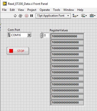

I need to read the value of 12  Holding registers that are received by Modbus protocol. Verified to be valid data using the Modscan32 tool.
Refer the VI attached ( LV2017) . I am able to read but the values are not right … I am not sure what value should I input in the Address . My valid address  are 40001 to 40012. Am I making a mistake some where ?

What is not right about the values?  What do you get and what do you expect?
For 40001 to 40012, then a start address of 0 and a quantity of 12 is correct. (Basically drop the 4, and subtract 1).
You could try a start address of 1, but that isn't common.  LabVIEW and the base commnunication protocol starts at 0 even though the human readable listing of registers in manuals starts at 40001 for holding registers, 30001 for input registers,   and other prefixes x0001 for the other various types of registers.

First Image : LV2017 code readout; Second image : Modscan32 readout ( Integer mode) . Note : The first register 40001 is a Digital Input - 8Bits ; Rest are all Analog Inputs of 4-20mA mapped to 0-27500. My interest is in the first 12 register and the last one has a temp probe connected to show the setup is working.

What is the display format of your array?  It looks like it is binary and you are seeing 1 followed by 15 0-bits.
Guess what, 1000 0000 0000 0000 as a string of binary bits is exactly equal to -32768 when those 16 bits are interpreted as a I16  (signed 16-bit) integer!
Your 0th element of that array is 0100 0000 0000 0000 (it has one less zero), which is 16384 when interpreted as an I16 integer.
So, what do you think is wrong?  You might need to typecast the U16 array to an I16 array.  Otherwise, set your numeric format in that array indicator to be I16 rather than binary.

Thanks.  That was a good point on the data type.
So afterall the Modbus toolkit is not bad Smiley Wink
