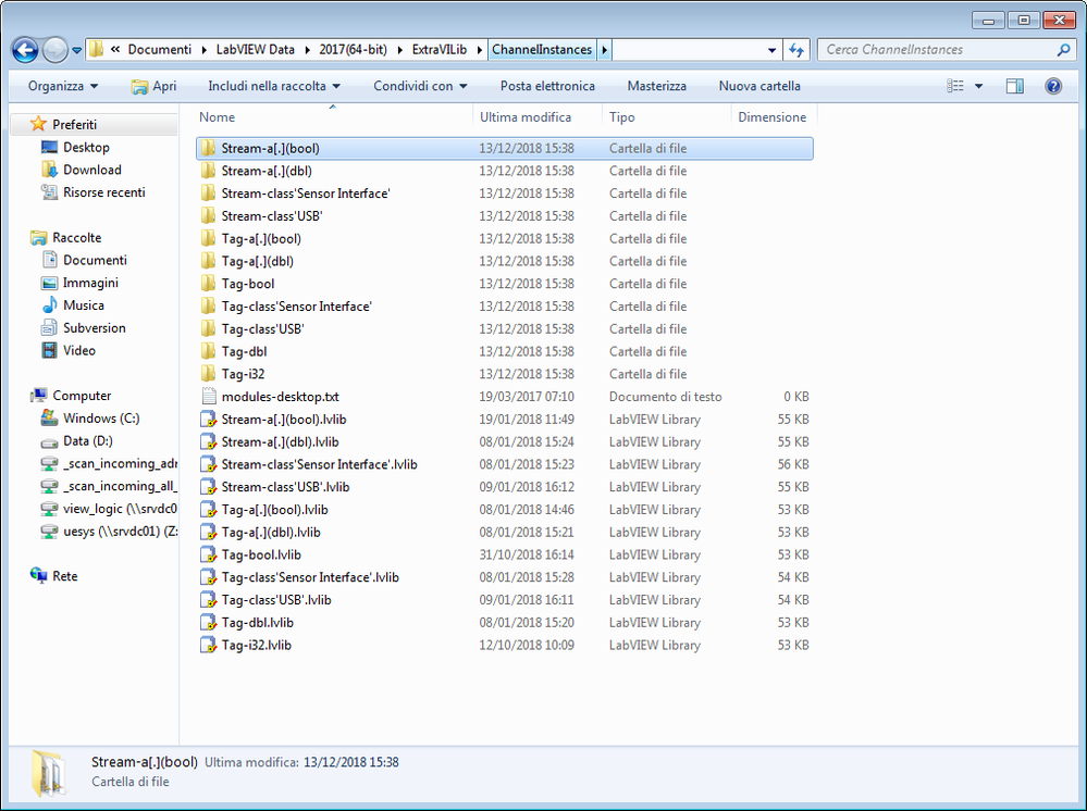

I'm Picking Up the work of a collegue, I need create a New Project and add references to vi copied
I fixed all the dependencies and i Went to Run it
but it didnt run
Error List.pngù
those VI and Class reference  are in
%HOMEPATH%\Documents\LabVIEW Data\2017(64-bit)\ExtraVILib\ChannelInstances
this is Bad because my Project base can not be dependent by the user logged in, i can't SVN those file
 is there a way to move them?
if you look at the project the vi are present in the last line of the dependencies and there is no signal fore errors or conflict but the progect do not run, the only hint is if I open the node
that class is not loaded, but if i go there and Load that the project manager say it cannot be loaded
no other Hint or possibilities...
How do I Fix the Import so that the project run?

Your code has a Stream Channel Wire in it, one based on a TypeDef called Sensor Interface.  I tried looking at your code to see where this is defined, but since you didn't post it, I can't provide additional help.

First backup what you have in "\ExtraVILib\ChannelInstances" so that you can restore it if needed.
Then just blow away the folder "...\ChannelInstances".
When you open LV and that project again LV should automatically recreate that folder.

To expand slightly on Ben's answer and to give an answer to the "missing class" question:
Starting with the introduction of Channel Wires in LabVIEW 2016, Channel Wires were added to LabVIEW.  Each Channel Wire requires code to support it, code that is generated when the Channel Wire is created and is unique to the Channel Wire "type".  The Design Team saved the code as a LabVIEW Library, but "named" for the Channel Wire, itself.  Where to save it?  If in vi.lib, then all Channel Wires for all users of the PC would live "together", and there could well be name clashes (especially Channels involving user-created TypeDefs).  If inside the Project, there were other "negatives", possibly related to "bloating" the Project (I'm speculating here).  So a decision was made to create an "ExtraVILib" for each User, "hiding" it in the User's LabVIEW Data folder inside a folder specific to the particular version of LabVIEW as the ChannelInstances sub-folder.
When you open a Project that has Channel Wires, as it loads the Project, it tries to connect with the corresponding Channel Wire support .lvlib file stored in the ChannelInstances ExtraVILib folder -- if it doesn't find the file, it regenerates it.
One consequence of the "User-centric" location of ExtraVILib, and the "Project-centric" nature of Channel Wire definitions, two Projects could define two Channel Wires with different properties but identical names, which produces a "clash".  The easiest (and, so far in my experience, perfectly safe) way to "fix" this is to simply delete the entire ChannelInstances folder from the appropriate ExtraVILib file in the LabVIEW Data folder.  Loading the Project will force all the Channel Wires to be recreated (which could take a minute or two) -- you should think about which (other) Project might have a Channel Wire of the same name but different "reality" (again, usually arising from a Project-specific TypeDef sharing a Name with a different TypeDef in another Project).  Decide which Project's TypeDef needs to be renamed, and avoid the Clash next time.

Thanks for the explanation but, i switched user and labview didn't regenerate the channel, that folder on the new user wasn't  there at all, i'll give it another Try but it was difficult to move code from one user to another and somehow the regeneration process wasn't seamless... i guess I'll investigate a little bit more maybe open a new post
