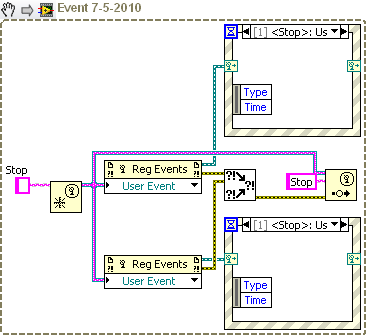

Here's a demo to use one user event with multiple event structures:
You can feed the event ref into the sub-vi. The registration is done inside the event.

Thanks Ton but..
That would mean that I would need to have another (2) event structures in my sub-apps(vis); 1 for the user events already registered on thier BDs and 1 for the 1 which is generated by the main app.
What is a way of avoiding this? (I don't think it would even work)
To explain again:
1. The subVIs are SM with their own user events and Reg Events on their BDs.
2. I want to be able to Generate a user event from the Main VI to send each of the subVIs commands.
Dilema - I cannot merge the Reg Events already on the BD of the subVI with the Reg Events I pass into from Main app using control.

A trick I never new worked:
You can merge event registration refnums with a 'insert into cluster'.
But my proposal was to have the Event Registration inside the sub-vi, so it should not be a problem.
So on the BD of the subVIs I register another user event which the main VI can use... correct?
But, how does the main VI use(generate) the event?  I need the output of the Create User Event which is on the BD of the subVI...

Here's my idea of such a structure:
I have placed the same VI twice on the Main BD. The inner Snippet shows the code of the sub-vi.
As you can see the only addition to a standard VI is that I added an Event registration and a cluster bundle function to a normal VI.
Good practice would be to register in the 'Data.Initialize' state and unregister in the Exit state. Destroy the user event in the Main VI's 'Exit' state.
Ton
My LabVIEW Ideas
Message 29 of 39
(1,900 Views)
You can merge Reg Events using cluster Bundle - Thanks Ton!
