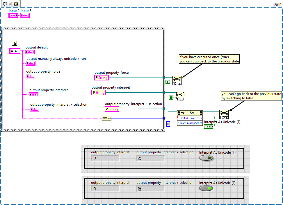

paul, why is that one  property node in your snippet  yellow and the other two are brown?
I can't figure out how to use your snippet directly, so I tried to reproduce using the property nodes from the NI unicode tools:
The brown nodes are for internal NI use only (super secret scripting).
There's also blue (scripting) and red (obsolete) nodes.
Message 5 of 10
(4,199 Views)
The node is brown because the property "Interpret As Unicode" is designated private.  Ordinarily I try to avoid using private properties, but since NI uses this one in an addon toolkit, I feel OK about it.
The "Interpret As Unicode" is definitely changeable back to False.  Note however that setting the "Force Unicode Input" property to True changes "Interpret As Unicode" to True.  When "Force Unicode Input" is true, when you're typing text into the string, it converts it to Unicode.
To use my snippet with a string control, get the Text reference from a string property node.
yes, I made a copy and paste error in my snippet's comment ....
I want to write "you can go back to the previous state" 😐
thanks!
hm ... 🤔
