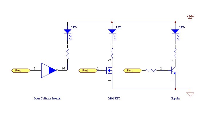

Hwew are some basic circuits I posted for a simmilar question a few years ago.
You would replace the LED and resistor with your valve.

If you do use discrete transistors/MOSFETs/Drivers also add a reversed biased diode (1N4004 shouldd suffice) across the valve coil to absorb the back-EMF when power is removed from the coil. Not doing so may fry the discretes along with your DAQ and maybe the PC too. The ULN200x's have the diodes built in.
