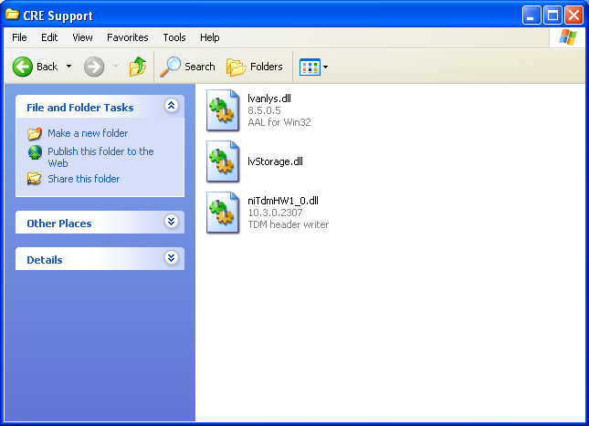

I checked the security settings for each of the three LV dll's that are included in my project. They are all identical, but I don't appear to have any problem accessing lvanlys.dll or niTdmHW1_0.dll. I tried adding read and execute priviledges to "Everyone" for lvStorage.dll anyway. It didn't make any difference.
While I was in the limited account looking at these things in Windows Explorer (the limited account still had the default Tile view set) I noticed that there is metadata associated with the other two dll's (see image). This may not be significant at all, but to me, it indicates that the three dlls were not all created the same way. Is it possible that some care needs to be taken when creating a dll to make it accessible to Limited Users, or to guarantee that any other libraries that are dynamically accessed by the dll also have those priviledges?
