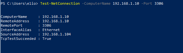

I think the problem is deeper than this, in the way Windows 10 and labview react together. I don't have labiew installed on the windows 10 machine, I just run the .exe
The thing is, from this machine I can access the adresse with port 3306.
But when I try to do exactly the same from labview, I get the error.
Please see here some pictures. Do you have an idea of what could cause this between LV and Windows ? On this specific Windows version ?I tried disabling firewall and security with no succes...

Check the Windows firewall settings if it has an entry for your executable forbidding to use TCP. It's damn easy to dismiss the dialog that shows up when a newly installed application tries to open a new network connection for the first time. Once you dismissed that dialog however, the firewall will do what it is supposed to do and simply fail any network operation not explicitly allowed in the rules for that application.
Error 1 is a parameter error which for the Open TCP Connection with the parameters you show is a pretty strange error, unless of course the firewall is blocking Winsock calls for your process and the Winsock address resolution that LabVIEW calls to convert the IP dot formatted string into an ipaddr to actually open a socket simply returns with an error (which it never should do for a dot formatted IP address).
And if that is the case your firewall is broken. It should not give itself away in such an obvious way to a potentially malicious process, that it is actively getting blocked.

Hi Rolfk and thank you for your help, I've just tried it but it didn't work.
(I tried to :
- add rules for port 3306 in and out :Always authorise
- disable all firewalls
- Add the specifi lv.exe to autorised softwares on the firewall.
No luck until now...

Problem "solved" ...
I installed WireShark and noticed some connections to the server but not my TCP...
So I tried to copy the labview.exe directly on the machine, instead of having a shortcut pointing to the Labview.exe on the server.
And it works fine.
It seems to be linked to the newest versions of windows which have not implemented Samba.
Weird.
