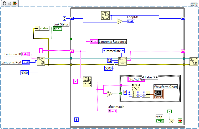

I am trying to read a TCP packet and parse the data and plot it.
The incoming data is in the format  " <123,456,78 "   The character '<' is the start marker and there is no CR or LF after the string.  Data string sent once every 100ms.
I have two issues … occasional packet drop. While this is not a major issue as the data pertains to temperature , I would still like to handle it properly as the plot shows it as a spike to zero. Can this be eliminated if I first get the data packet size and then feed that into the TCP Read ??
Second … the Scan from String always returns a error even if I invoke it only for valid data string. Whats wrong ?

You make the classical parsing error, assuming that your computer program is slow and magical enough to only call TCP Read in Immediate mode when a complete message has arrived. If the interval between the messages is long and the message itself is very short, then the chance for that is very high, but never ever 100%.
Imagine TCP Read executes at the moment the other side is sending data and only reads the first byte (or the first few bytes). TCP Read in immediate mode will return ... indeed immediately as soon as it sees at least one byte in the incoming buffer! Your parser concludes: Hurray I got a message, passes it to the Scan from String function which concludes, wtf I didn't get enough data and throws an error.
Now the solution seems obvious: use the error indication of the Scan from String function to determine if the message was valid and if it wasn't just put the string in the shift register anyhow to wait for the next round and prepend the previous string to the received message.
EXCEPT: what happens when you called TCP Read when all but the last or last two characters of a message like <123,134,145 has been received?
Exactly: Scan from String will be happy and decode it into 123, 134, 1 and present it to you as a valid measurement sequence and you are still in trouble.
There is only one fairly fool proof way to avoid that: If you got any valid data with your start marker in there back, you need to do a second TCP Read with a small (significantly shorter than 100ms timeout) and repeat that until you do not receive a string with a start marker. That entire string starting from the last occured start marker you then pass to Scan from String and whatever this function doesn't consume if any you put in the shift register for the next round. What I don't like about such a solution is the inherent timing used in this scheme. It assumes that the sender never will get changed to send messages faster than 100ms or it all falls apart. Generally timing fixes such as delays or whatever in protocol handling communication is a sure way to get into trouble later on. But in this case with such a stupid protocol I can't think of something else.
This all may sound complicated and it is in fact, but that's what you get from a stupid protocol like this that doesn't have a fixed size AND no termination marker either. The only possible termination marker left is the fact that after the end of the message there won't be more characters for almost 100 ms. The usual excuse that it doesn't need any protocol characteristics as it was only meant to be displayed in a terminal also falls totally flat on its face: Try to display such a string in a terminal without at least a <CR> and/or <LF> at the end of the string. Guaranteed headache for anyone trying to make any sense of the numeric gibberish in the terminal screen.

Thanks to the analysis of the problem, it helped to open up new avenues. I have now got a solid TCP Read. Two things helped :
1. Increase the Serial Baudrate of the device server ( Serial to TCP convertor )  9600 to 115200 bps.
2. Add a CRLF to the end of data string and use that as a delimiter in the TCP read .
Worked great ... been running for almost an hour and not a single dropped packet. To observe this I was sending a saw tooth waveform and plotted it ... you can see it below alongwith the code that worked .!TCP Read Refined.pngWaveformPlot.JPG

Since you are now using a termination character sequence, you really should set the Bytes To Read to be more than any message could possibly be.  I would bump it up to more like 50, just to be safe.  The read will still end when the CR LF sequence is read, but this gives you a lot better chance of not being caught off guard when a message comes in that is longer than you expect (maybe 20 characters instead of 12).
