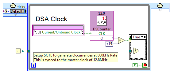

Here are some pictures that will hopefully help you.
In the the figure below, I have a SCTL that is counting pulses from one of my DSA Sample clock. The sample clock for the DSA runs at 12.8MHz. I am counting 16 cycles of this clock, such that I am generating an occurrence at 800kHz. (12.8MHz/16 = 800kHz) (Note I wanted my modules to run at different rates, but be synchronized.)
I have another loop that has all of my DSA modules, see below. These modules are synced to the "Current" sample clock. They are running at a much lower rate than 800kHz.
Next I have two loops for my SAR acquisition. Since I am acquiring data at a high rate, I am using the Sample Pulse method. For lower rates this is probably not needed. Note that the pulse that starts sampling for the SAR module are tied to the occurrence. You will need to do something similar for your application. Have a separate loop where the sampling waits until the occurrence.
Note the delay is still needed, as there is a delay for each channel acquisition.
Hope this helps.
mcduff
Message 7 of 32
(7,682 Views)

Now i still have another question:
since i want to acquire 32 signals from my SAR, is such a sequence of FIFOs as in your last picture still viable? My 9220 has a data rate of up to 100kS/s/ch, so much lower than yours. Will putting the SAR data into an array and delaying that by 40 samples work as well? I would like to avoid putting 32 FIFO writes into a loop. I am also not quite firm with how overhead would then affect my system. And i also have to take a better look at the DSCounter and the available options it gives me.
Message 9 of 32
(7,641 Views)
At a lower rate, a loop should be acceptable. In the pictures I showed, the data for the DSA modules was all in a loop.
The delay for the SAR will depending on the sampling rate of your DSA modules. If the delay occurs for the array that should also work, instead of each individual module.
Post some pictures of what you are doing.
mcduff
