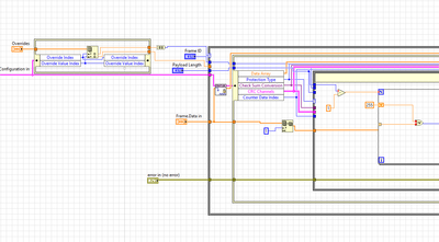

Hi YZOng.
Thanks for the support.
Now I have a question. This new protection data I created. I need to get all the data from the payload then I will calculate.
I write the code like blow is it correct?
For example: I have payload with length = 8. I need to get byte 0, 1, 2, 3, 4, 5, 6, 7, not get by signal type because my signal can be greater than 255.
Thank for support
Message 28 of 29
(125 Views)
Hi Mr ,
 I edited the calculated checksum to my liking, but it seems to be faulty somewhere causing the CRC to always be 0.
 Can you see where I went wrong regarding the integration of signal values ​​into a frame can?
Tks
