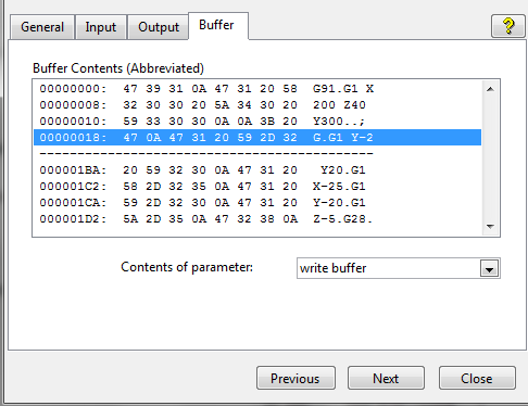

Well... now I did separate the NI IO TRACE line where i send the "long string" and as you can see (in the --- line) thats where the break goes
exactly at 190 characters... i don't know what this means or how can i fix it tho... 😞

Can you show as the part of the LabVIEW code where you write your string?
And I still don't understand how you determine that the writing stops after 190 characters...

I know because i can count where the machine stops and where that screenshot shows:
G91
G1 X200 Z40 Y300
; G
G1 Y-20
G1 Z5
G1 Y20
G1 X50
G1 Y-20
G1 X-25
G1 Y10
G1 Z-5
G1 X25 Y-13
G1 Z5
; X
G1 X-50
G1 Y-20
G1 X25
G1 Y20
G1 Y-25 X25
G1 Z-5
G1 Y-3
G1 Z5
; A
G1 X-50
G1 Y-2 (Exactly 190 chars)
Please note the label on that string indicator;
Buffer Contents (Abbreviated)
I believe it is tell you that it is not showing you the entire write buffer. Check your setting in NI IO Trace to make sure you are not chasing a red Herring.
Ben
Message 19 of 30
(2,249 Views)
Actually that screenshot shows the Write buffer contains 473 characters (ending in (\codes) "Z-5\nG28\n" .  the "----" is there as a placeholder for the undisplayed portion.
