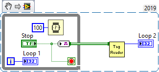

When you want to stop parallel loops, you need a way to "get inside the loop".  In the "old days", there were "References" that could be passed, but they were clumsy, and did not maintain "data flow" (you had no "wire" for the reference).  In LabVIEW 2016, the Asynchronous Channel Wire was introduced, and makes a very intuitive way to pass things "asynchronously" (here meaning "instantaneously") from one loop to another.  Here's a simple example with a Stream Channel wire:
The Stream Channel Wire is created by a "Channel Writer", the rectangular item in the first Loop that takes the Boolean "Stop" control in and exports a "Green Pipe" -- green for Boolean, pipe as a metaphor for Asynchronous Channel Wire which passes over (not tunneling through) the "wall" of the While Loop.  The second (receiving) Loop has a corresponding Channel Reader that takes the Boolean out of the Stream and sends it to the Stop Control of the second loop.
The Stream Channel Wire is like a Queue -- everything put in one end is sequentially read at the other end.  If you run this code, you may be surprised at the results -- the second loop will not stop until it reads all the commands from the first Loop, namely "Go, Go, Go, ..., Stop", and as it is the slower loop, it finishes later, and shows it looped as many times as the first loop.
To get the two loops to stop at the same time, replace the Stream Channel Wire with a "Tag" Channel Wire, where the Reader only reads the most recent item (if any) that is passed in:
This behaves as you would expect -- the two loops stop at the same time (with the second loop showing fewer iterations).

@Bob: Very clever way. Didn't know of the pipe. However, it doesn't help to end the sub VI. I also opened another thread where the topic was to end two loops at the same time. Did you perhaps want to answer there?

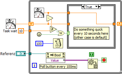

This code is too simple! What does the FOR loop actually do? If it does a hard calculation that takes 10 seconds, it needs to complete. If it just does something quick every 10 seconds, use an inner loop to poll the button. And why is is a FOR loop instead of a while loop? I really doubt that waiting for 100000x 10 second iterations (11+ days!!!!) for a natural termination of the loop is reasonable in any scenario.
Here's one possibility (might need some tweaks, depending on if you want the first task a 0s or 10s, etc.):
Message 8 of 11
