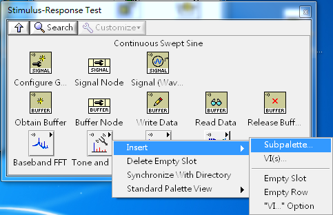

I have the same question.
The"Stepped Swept Sine VIs" had been included in "Sound and Vibration Measurement Suite" for a long time.
It belongs to "Swept Sine" palette, and can be found at  Function Palette "Sound and Vibration"->"Swept Sine"->"Stepped Swept Sine VIs" in LabVIEW 2009 to LabVIEW 2012, as shown belows:

However, the "Swept Sine" palette had been replaced by "Stimulus-Response Test" palette in LabVIEW 2013 to LabVIEW 2015.
LabVIEW 2013 Stimulus-Response Test VIs
LabVIEW 2014 Stimulus-Response Test VIs
LabVIEW 2015 Stimulus-Response Test VIs
But the "Stepped Swept Sine VIs" palette has just disappeared!!

After consulting NI FAE, I got a temporary solution for this issue.
STEP1: Install Sound and Vibration Toolkit(or Measurement Suite).
If it's installed corretly, you may locate "Stepped Swept Sine VIs" in the path
"C:\Program Files (x86)\National Instruments\LabVIEW2014 \vi.lib\addons\Sound and Vibration\svt_Swept Sine\"
STEP2: Select  "Tools»Advanced»Edit Palette Set"  to display the "Edit Controls and Functions Palette Set" dialog box.
STEP3: Direct to Sound and Vibration->"Stimulus-Response Test" subpalette.
In the last row, you might only see the "Contiunuous Swept Sine"subpalette, but not the"Stepped Swept Sine"subpalette.
STEP4:Right-click an open area on the palette to insert subpalette.
Select "Link to an exiasting patette file (.mnu)"
STEP5: Select  "svt_Swept Sine(DAQ).mnu" and press ok.
STEP6: Press"Save Changes" on the "Edit Controls and Functions Palette Set" dialog box.
And...it's back!
Refererence:  LabVIEW 2014 Manual:  "Editing a Palette Set"
