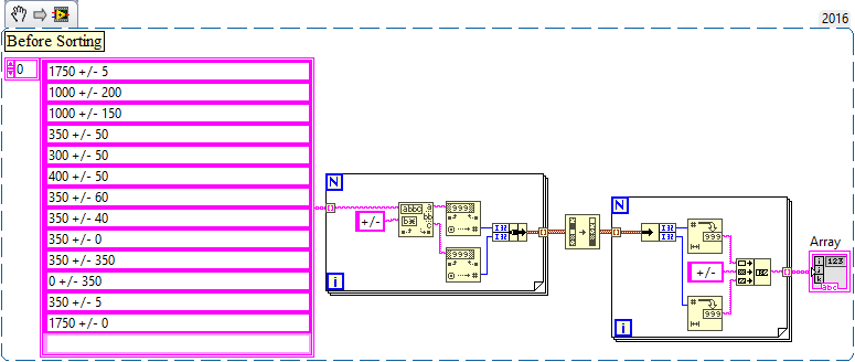

Hello LabVIEW community.  We all love puzzles, yes?  Well here's one for you as I was working on a sorting function cuz this one required me to do some serious thinking because of all the different scenarios that could take place.  So I'd be curious how everyone else would do this.  I'm always impressed by some of the much simpler ways some of y'all come up with.  I'll post a picture of the issue and the VI (in LV2015).  The goal is to get the data on the left sorted to look like the data on the right.  Good Luck.  Smiley Happy  (not terribly hard, but still fun I thought)

Assuming the first number is less than 10000 you can do something like that:
-multiply the first number by 1000 and add the second one
-sort this 1D array
-recreate  the string array
You can use a bigger scale factor if necessary. Of course it is not universal and would have like to find a 1 or no loop solution but this seems to be an easy way to do this.

1) Use "match patern" with a patern of "+/-" in a loop to break up each string.
2) Bundle then into a cluster with the "Before substring" in the first element and the "After substring" in a second cluster element.
Note:
Verify the cluster order such that the first part is cluster element 0 and the second string is element 1.
3) build an array using an autoindiexing output tunnel.
4) Pass the cluster to sort 1-d array
5) Take the sorted array and put the two parts back together again with " +/- " inbetween.
Done,
Ben

*Edit: I posted before I had read any replies to the post, I see now that I am only repeating Ben's solution...*
Fun exercise! It took a while for me to figure out an "acceptable" solution. I ended up doing this:
(assuming only standard functions is to be used, of course)
Message 7 of 17
Oh, very nice!  Kudos awarded.  Also... I think this is what Ben was talking about.
