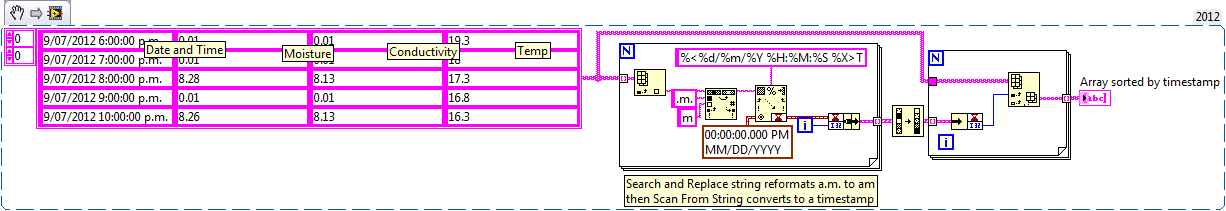

Hi
I have a 2D array. The first column is Data and Time. The date is in wrong order but time is right order. I want to re order the date without change time's order. How to do?
Please have a look the vi attached.

I'm not sure why you added to a 2 year old thread rather than starting a new one since your question is different from the one originally posted here.
This code should do what you want:
