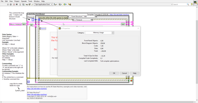

Recently i'm in a new situation where I have a slow labview performance at the block diagram when I copy objects or when I save the vi. For example, copy takes more than a second or two (i'm faster than Labview) and save takes more than 5 seconds.
I started to search in the forum for similar issues and one cause is the size of the VI. That people considered a Main.vi bigger than 1.5MB to be extremely large. But I can easily achieve those values with a simple project like the one that I attach (a very simple one where I use a JKI state machine and some DQMH modules - i'm starting on DQMH).
I asked a friend to test with his projects and he has the same thing. Usually the size is easily between 1MB and 2MB.
But it's normal to take so long with a size like do one that I mention?

That's really a small size. I placed a JKI state machine in a new VI and the value on the block diagram is 250K. So I don't know how you can do it.
The small example that I attach communicates with two spectrometers, one camera and uses a NI MIO.
Can you describe what are you doing on your "super-busiest" main?
Thanks for your help!
Sure, I have several loops doing different things with two queues and several dynamic events.  It is highly modularized, though  I don't really have anything but subVIs at the main.vi level.  That's probably why it's so small.  All my loops are in subVIs.  The complexity is 0.5.

I see where I'm misunderstanding.  You're talking about total memory, not physical size on the disk.  I am sorry.  I have a similar memory footprint.
