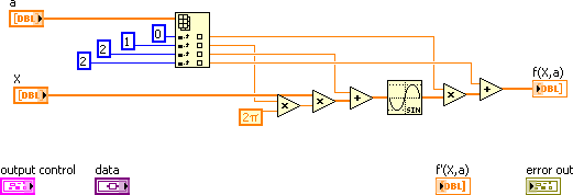

I fist worked about acquisistion problem and I have just come back my sine-fitting subject.
1) I did a "sin model VI" :
2) I did another VI which call my model and use "Fit non linear....vi"
3) but I obtain this message error :
What is the problem ?
What about my solution for calling the "sin model.vi". It looks like complicated to obtain the VI refnum but it works ? Is there a easier way to do it ?
Yes, use a static VI reference, point ot to the model, and make it strict.

benj wrote:
Look at the blue diagram constants! You are indexing element 2 twice and omitting element 3.
If you want elements in order, you should never wire the indices of index array. Delete all these blue diagam constants and it is much less likely to make mistakes like that.
