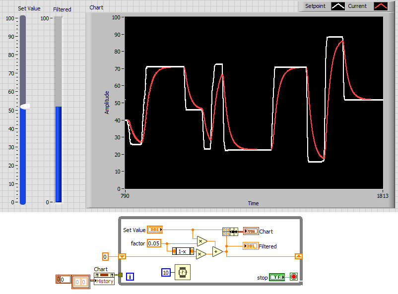

I want to add a sigmoid function to my waveform chart. Right now when I increase the throttle the chart shows that the amplitude changes to the new value straight away without  a delay. So I want to implement a sigmoid function that takes me from the initial value to the final value with a smooth S curve implemented. Is there any way to do this?

The issue is lets say I use y=1/(1+e^x) the x is a time value that is a part of the waveform chart rather than be in input so I am finding it difficult to implement this? I hope that makes sense

Maybe all you need is an exponential filter.
The entire "filter" can easily be wrapped into a subVI. An example for multiple channels can be found here, but you could easy create a VIM that accepts scalars and arrays.
Message 7 of 8
(1,571 Views)
@altenbach wrote:
... but you could easy create a VIM that accepts scalars and arrays.
Here's how that could look like:
