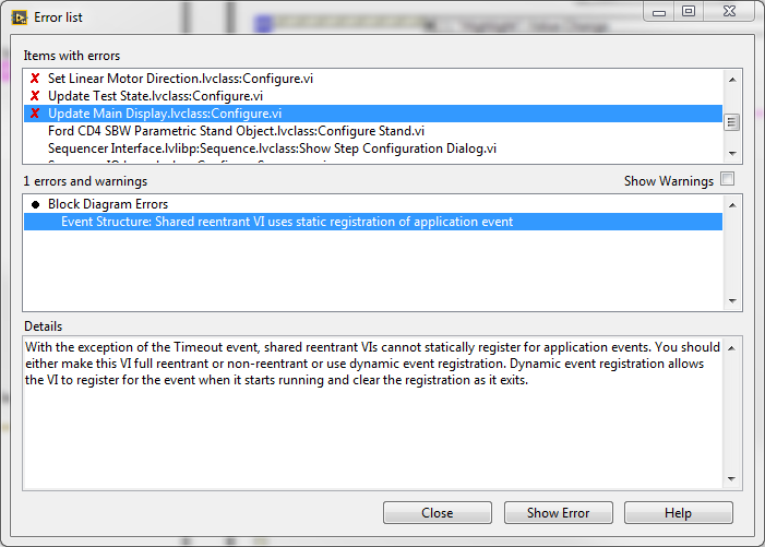

Shared reentrant VI uses static registration of application event
I'm upgrading a project from LV2011 to LV2014 and have hit a snag. I've got a reentrant VI that is throwing an error for statically registered application events. Is this a bug when upgrading from 2011 to 2014? The execution options are different between the two versions. Is this possibly a bug when upgrading?

Looking at the events, there's another strange message. The warning at the bottom indicates there's something amiss inside of the VI.Reentrant error 2.PNG

Aah, the joys of developing shared code! Turns out that the VI heirarchy is dynamic dispatch, not static, and trying to call the Application Instance Close? event (which is apparently static) causes the error. Deleting the event case clears the error.
