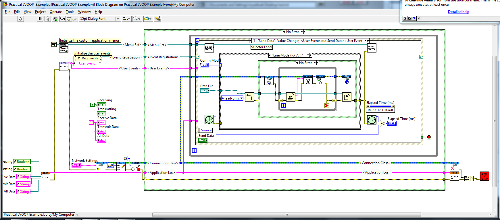

If you have wiring nightmares or require lots of locals it is generally a sign of a poor programming architecture. I work on large systems (1000s ov VIs) and very rarely use locals. They are generally only used in UI code. Also, any of our code that starts to look messy will get refactored so we have clean code. It is much easier to maintain and extend. Here is a typical looking block diagram.
Mark Yedinak
Certified LabVIEW Architect
LabVIEW Champion
